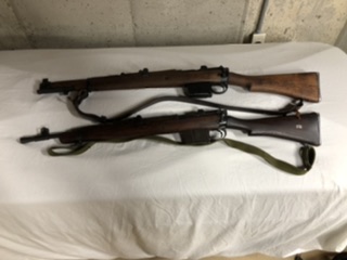

I’ve got two rifles that never were. The first bears a Numerich import stamp the other has no import marks. One is a cut down Ishapore 2A1 made to mimic a Jungle Carbine the other is also a cut down Ishapore and referred to as a Bulldog Tanker Carbine. Both needed extensive work to the recoil draws but turned them both into great fun shooters

I always kinda sorts wanted the tanker, but as a No4.
Then I heard about several of them literally blowing the front end off where the shortened stock was re-spliced under the sling swivel band!
I lost interest at that point.

The story was true.
Mine did exactly that. The splice was literally put together with Some sort of paste and a wooden dowel. I did a proper repair using Acraglas and inlaid brass pins. 100 rounds later and no more issues.

Gibbs Rifle Company made them for a time. My dad has both of those rifles pictured. The story told to him from a private seller was that they were one off rifles and never put into service. I fpund out later in life that Gubbs Rifle Company,now Navy Arms made them. Visit their website.

You and your Dad are correct. I have done some reading about Gibbs and Navy Arms. I intend to contact N/A to ask if they have any documented history on these rifles.

FWIW most of the "shortened" Gibbs rifles were made that way because of cord wear at the muzzle from incorrect, or over use of the pull through.
The simply chopped off the worn section, re-crowned & trimmed the wood, & Bingo done!
"The Gibbs Rifle Co", should NOT be confused with the original "J & G Gibbs" in England who made (& still make) one off, hand crafted bespoke rifles!
