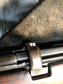

I fired these rounds yesterday. I used new Hornady 308 cases with CCI 200 primers , Hornady 165 gr, SST bullets with 42 gr. Of IMR 4895 powder. I thought this load would be fine but the signs say otherwise.
Any thoughts?

According to Hodgdon and using Fed 210M primers, they indicate a starting load of IMR 4895 at 40.7grns. The psi is only 49,200 with a velocity of 2584.
It gives a maximum compressed load of 45.5grns, a psi of 58,800 and a velocity of 2745.
You might be experiencing an issue of not enough powder. The line around the fired case is well above where a case separation occurs and may have something to do with the way the chamber was reamed.
What rifle are you experiencing this issue with?

This is the load data I was using from Hornady
There are no Americans in Baghdad!!
Date Posted: October 14 2020 at 9:54am
You are right on the cusp of a max charge. Hornady has a starting weight of 35.0grns of IMR4895. Always start with the minimum and work your way up.

Hodgdon lists load data for the .308 Winchester and .308 Service Rifle.  The .308 Service Rifle data is intended for self loading Service rifles chambered in 7.62/.308 such as the M14 and M1A.
This is the load data for .308 Service Rifle for 168 gr SMK with H4895.
Date Posted: October 15 2020 at 9:02am
That suggest that the OP loading with 42 gr was right at MAX load (Max = 42.3gr)
Unsurprising that there are signs of over-pressure.
Date Posted: October 15 2020 at 12:29pm
Flattened primers will often indicate excessive headspace, particularly with new or full length sized cases.

I asked myself this exact question when I started my conversions using the 2A1 barrel knowing full well I was going to use once fired 7.62x51mm NATO brass full length resized in 308 dies. I have a 308 Field gauge @1.638" so, the choice was obvious.  I did what I had to do and ended up with a rifle that has extremely tight tolerances as far as headspacing goes.
The fired cases show no signs of stretching, and the primers did not flatten. The 308 Winchester is not entirely identical to the 7.62x51mm NATO, owing to differences in tolerances; therefore, some commercial rifles will not handle military ammunition.
   The OP started out with a charge weight right on the edge of maximum and the result was a stretched case and flattened primers. He ultimately needs to start over and load to the minimum starting charge weight.  If he observes flattened primers and excessive case stretching then make the assumption that headspacing needs to be corrected.

Posted By: Frameman 1
Date Posted: October 16 2020 at 2:41am
I’m in deep water with the headspace measurements. I personally have no way of accurately measuring headspace. Can a “reasonable “ bolt face to case gap measurement be accomplished? And how to do this?
Date Posted: October 16 2020 at 4:25am
No.
303 is a rimmed case that you can measure from the bolt face to the rim.
308 is a non-rimmed cartridge and the headspace is taken part way down the taper of the chamber.
It cannot be measure against the bolt head and the case rim.
Date Posted: October 16 2020 at 5:08am
I understand that the registers for the case seating are taken from different parts of the case but the fact remains that in both calibers the case contacts the chamber wall to stop its forward motion.
That being said, shouldn’t the bolt to case gap still be a relevant measurement?
Date Posted: October 16 2020 at 6:17am
If we shoot new .308 or 7.62 NATO ammunition, or full length sized cases with .308 dies, case external dimensions are the same.  Ergo, a .308 SAAMI gage will provide a satisfactory indication of the chamber headspace to that standard that is safe for these cartridges.  Yes, military 7.62 chambers are generally longer than SAAMI .308 chambers but not the other way around, so you will be safe using SAAMI gages.
The other way to check this is to use a case headspace gage.  I use the Hornady gage to measure the case headspace after firing and set my FL reloading die to push the shoulder back .002 to .004 inches and no more.  You can measure new cases as a reference and determine how much the case is elongating to fit the chamber.
Although we don’t know the exact chamber dimensions used by Ishapore, we do know that .308 brass can be safely fired if the chamber measures within SAAMI .308 specs. Both my No. 4 converted rifles do, the bolt is a long way from closing on the .308 NO GO gage.
Date Posted: October 16 2020 at 7:34am
With a 303 there should be a minimum gap between the case rim and the front of the bolt head. If there is a large gap then a different bolt head should be fitted.
In reality a small gap is always likely to exist but head 'clearance' should be minimised.
Changing from 'quality' cases such as PPU or Military cases to the thinner rimmed SAAMI cases means that this 'clearance' space is increased, effectively increasing your headspace.
If your headspace (on a 303) is close to the maximum, your headspace can be actually pushed over the top by using 'thin rimmed' cases, or reduced by using 'thick rimmed cases'
Take the example of a rifle 'just' passing the 0.074" No-Go test and has a headspce of 0.072".
If you use a SAAMI spec case that has a Rim thickness of 0.057" then you now have a gap of 0.015" between the rear of the case rim and the front edge of the bolt head. On firing the case expands binding on the chamber, the rear of the case can move backwards by 15 thou before it gets any resistance so, stretching the case and ending up with a weak point at the 'case web' and the infamous "Enfield Ring Of Death".
This ring is not the fault of the Enfield 'generous chamber' but of the owner using thin rimmed cases without checking their effect on the headspace and head clearance.
An interesting little Gif (By a poster called Parashooter)
If you took a cross section of a 7.62 chamber you would see that the cartridge case 'fouls' the neck taper on the chanber - this is what stops the cartridge moving forward and where the headspace is normally taken.
On a 303 the cartridge is stopped moving forward by the rim hitting the breech. You can see in the above Gif that prior to firing, the case does not touch the chamber at all, and is the reason for the 'trick' of using a rubber ring (hair band etc) to centre the case in the chamber - otherwise it just sits in the bottom of the chanber.
On firing (both 303 and 7.62) expand to 'fit the space' and then, as long as their elastic limit has not been exceeded, will revert back to (almost) their original dimensions.
Date Posted: October 16 2020 at 8:05am
One thing for certain is that military rifles don’t consider cartridge case reloading.  As long as there is a margin on case head ruptures, it is of no concern if brass elongates.  Not so for us who reload.  We want headspace to be tight for long case life.
The No. 4 Long Branch 7.62 converted rifles were built for target shooting purposes which likely explains the relatively tight headspace that conforms to SAAMI .308 Win specs.  I suspect that’s how they set the headspace on these rifles even though they would be used with Canadian issue 7.62 NATO ammunition.  Not being a machine gun where cartridge feeding reliability is a primary concern, they likely saw no reason to ream the chambers out to NATO specs intended for MG use.   I’ve got a 1960’s DCRA instruction sheet on converting .303 barrels to fire the 7.62 cartridge and these instructions call out the use of a .308 Win reamer.
I have no idea what Ishapore did for chamber headspace on their rifles, but if the OPs rifle is indeed to the high side of 7.62 NATO specs, and a new .308 case was used, a flattened primer is going to occur, likely with light loads as well.  Also pretty severe case headspace elongation.  That would also happen with a 7.62 NATO case.
Date Posted: October 16 2020 at 12:43pm
