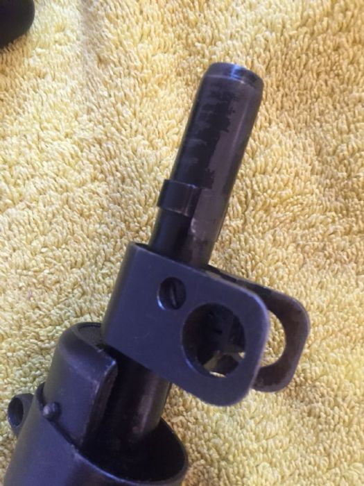

Hi All,
As per my introduction post in the new members section, I discovered this forum when doing a little research on a rifle I own.
I wonder if anyone here can answer a few questions I have about it?
The rifle in question is a Fazakerly No4 Mk2, dated 49. It is in 7.62 not .303 and it has a sterling magazine. When I purchased the rifle I thought it was a Sterling conversion however, one thing that has stumped me is the bayonet lugs...
Does anyone know if the sterling conversion barrels had bayonet lugs? The lugs fit an No4 ‘pig sticker’ perfectly and it keeps the bayonet in place when firing.
In addition it still has the extractor screw in place unlike other 7.62 rifles that use the mag lips to aid extraction. Is this another trait of the sterling conversion?
A few guys have had a look at the rifle when on the range and they are stumped as to what it is. I have also spoken to a guy who worked at the Enfield Factory and he didn’t have a clue either.
There are no L8 markings on the rifle.
I am still leaning towards it being a Sterling Conversion but I thought I would ask here to see if anyone may be able to help.
Thanks in advance
John

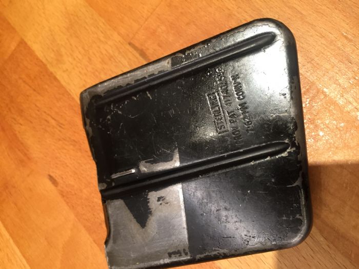

The mag is identical to the sterling mag pictured but it will take L42 mags as well. The rifling is 6 grove right hand twist. Identical to the picture of the muzzle above

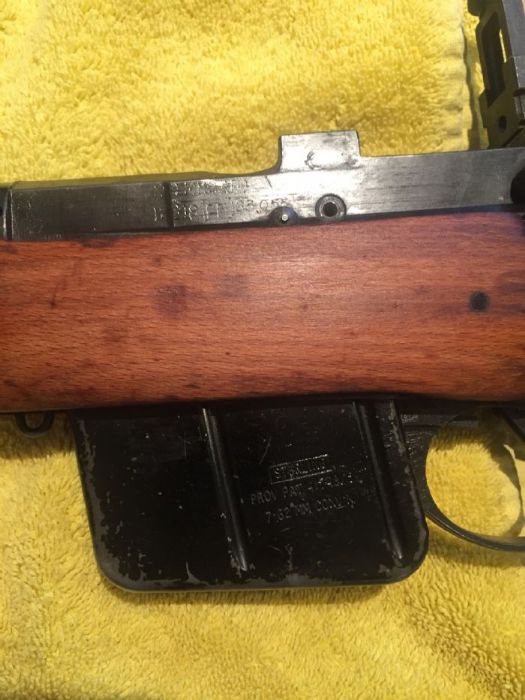

I hoping these pictures work - it’s not a museum grade rifle but it goes bang and is pretty accurate (enough for me anyway)
To be fair it’s almost identical to your Rifle Goosic bar the scope, it even has the cheek rest fitted. It has also been taped for a scope at some point - not a no32 scope though!

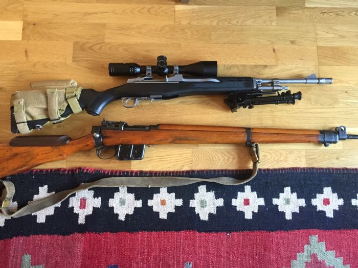

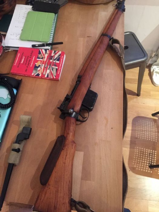

I found a full length picture of it with my Mini 14 on my iPad, I have taken the awful varnish off it now and recoiled it giving it a much nicer finish. I would love to get to the bottom of its origins.

I would think that U.K. rifle clubs were also converting No. 4 .303 rifles to 7.62 target shooting rifles by the late 1950’s as they did in Canada, prior to the L39/Envoy being available.  Although, I thought those were done at Enfield, perhaps there were retired Armourers doing this as well for club members.  Such a conversion done for private use probably would not have the L8 redesignation markings on the receiver.
Any indication of who made the barrel?  Long Branch 7.62 barrels are stamped CA (Canadian Arsenals) and also have 7.62 stamped near the muzzle.  Skennerton mentions several different manufacturers of 7.62 barrels that were the same weight as the .303 barrel.
Posted By: Sinnlover
Date Posted: January 13 2021 at 1:30pm
Unfortunately the only markings on the barrel are those picture above, nothing on the muzzle
I think it’s highly likely it’s a rifle cub conversion, it’s the lugs that are baffling me though.
I think I need to get hold of a copy of Skennertons book.
Date Posted: January 13 2021 at 1:47pm

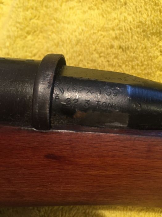

The barrel in my photo has never been on a rifle until very recently. It has a very tiny Canadian Arsenal stamp on it with a 61 next to it. It has bayonet lugs as well. Ian Skennerton states that:
A special barrel was developed for the Enfield L8 rifles, of chromium molybdenum alloy steel, it also had a hard-chromium plated chamber. The new 7.62mm barrel rifling has a right hand twist and in 1961, 6 groove rifling was used experimentally for the 7.62mm barrel. Many of the conversions were done at Enfield. The bayonet lugs were retained as such with some rifles having them omitted. The L8 series was discontinued due to discrepancies within. Another program was developed to find a suitable sniper riflefrom the original No4 model. The end result being the L39/42A1 rifles...

Cheers, I will have a look tomorrow when the light is better, I will also put a light down the chamber to see what it looks like, from memory it is light in colour and of a different material to the .303 No4 my father owns. I Might need to give it a clean first through, it’s filthy.
The barrel is a six groove with right hand twist.

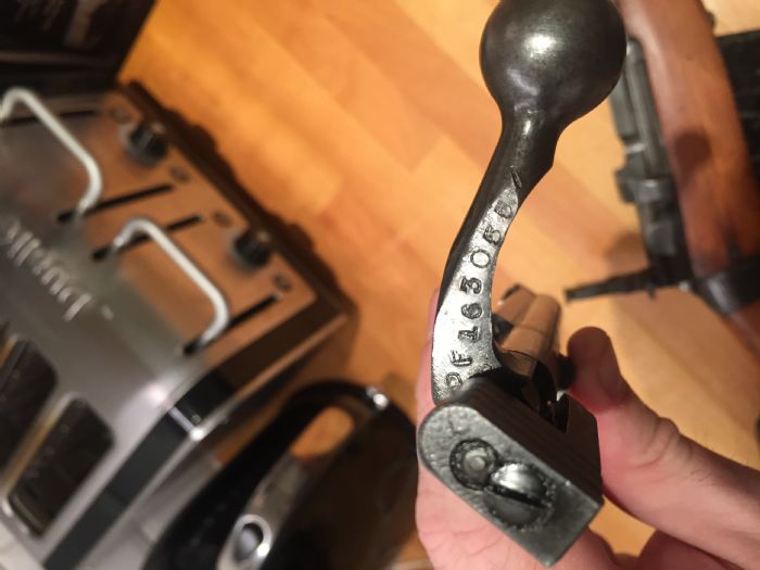

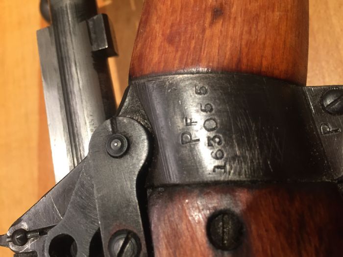

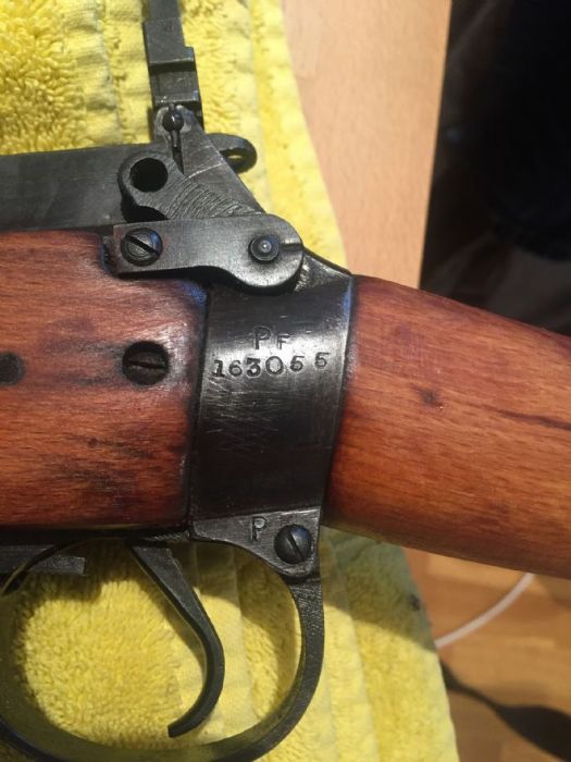

What is the serial number if you wouldn't mind please...
Date Posted: January 13 2021 at 2:53pm
It’s PF163055
Date Posted: January 13 2021 at 5:36pm

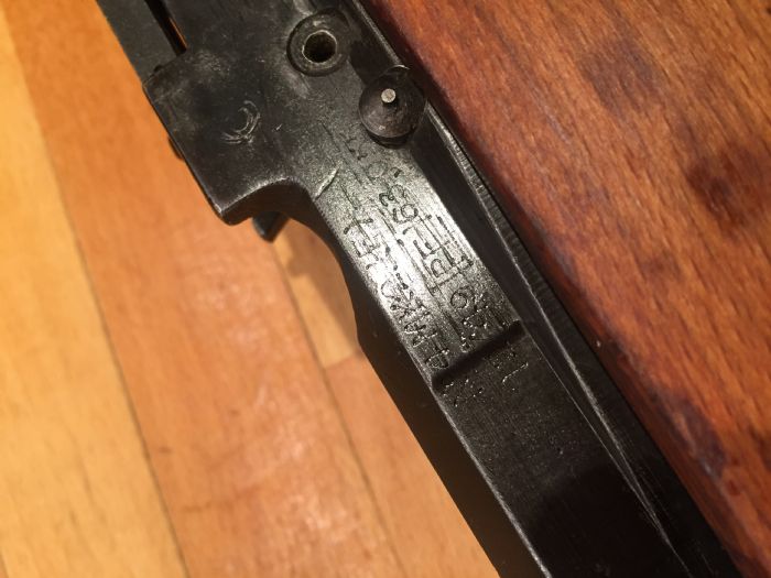

There are some electro stencil marks on the flatside of the reciever as well. Could you get a photo of that too please. Include a clear shot of that pin in front of where the ejector screw used to be as well please.
The serial number indicates that it was made at Maltby and at some point in time it went through a FTR and had the Mk1/2 upgrade done as well. Something about that double struck F has me bothered as well as that P stamped in front of the trigger guard screw.

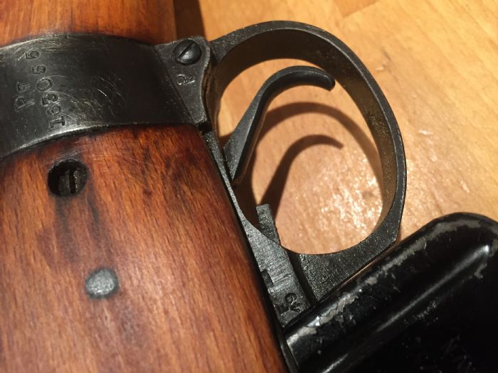

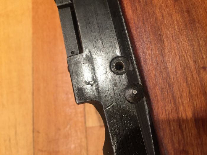

I have taken a few more pictures this morning - it’s more interesting than starting work!
It’s pretty grim here at the moment and the light is poor so hopefully the details come out in the pictures, I have had to take them in the kitchen as this is the brightest place.
The electro pencil marks as follows
No4 MK2 (F)
12 49 PF163055
The bolt has the matching serial number.

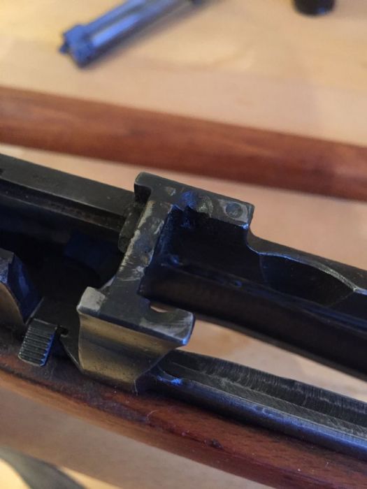

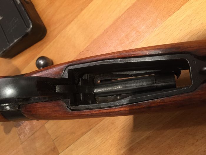

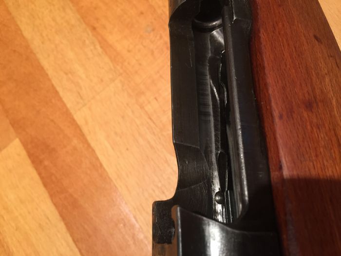

I have also included a picture of the chamber and inside the mag well along with the pin both inside and out.

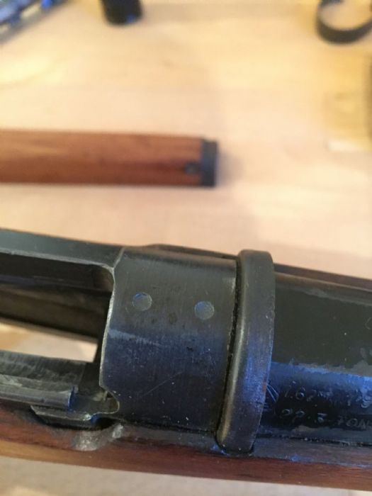

Apologies for the extra post but if you look at the last picture you can see the holes for the scope rail, these have been filled (by me) there is another hole on the charger guide for the rear of the rail, the charger guide is the 303 type, it does not hold the 7.62 chargers.
The barrel does not appear to be blued it is covered in a black paint that is chipping off in areas, could this be due to the alloy used in an L8 type barrel? e.g. The alloy was not able to be blued?
Date Posted: January 14 2021 at 1:50am
The electro stencil marks on the slabside is where we will start. Your rifle was manufactured by the Fazackerly factory in 1949 as a No4Mk2 with a serial number of PF63055. Whoever refurbished the rifle with addition of a scope did not pay attention to the box around the PF and saw a 1 in front of the 6 and transferred the Pf 163055 to the wrist and bolt handle by stamping them in. The f is of the wrong font and someone ground away the original serial number from the bolt handle. You can just make out part of a number just past the second 5. If it was the original bolt the serial number would have been electro stenciled in as well. When Fazackerly went to the electro stencil, they did away with stamping the serial numbers into the wrist and into the bolt handle.  The ejector tab looks to have been done professionally which could and would suggest that Fazackerly did the conversion originally which included a Sterling magazine, a L8 series 7.62mm barrel and a dip in suncorote paint. Someone after the fact recieved the rifle and added a scope mount and a new set of serial numbers to a mismatched bolt assembly due to the original being lost or misplaced...
Date Posted: January 14 2021 at 2:53am
Ah-ha! that makes sense as the electro pencil marks do look to have a box around the PF, I noticed that some time ago but I thought the missing 1 was a mistake as the wrist and bolt were stamped the same.

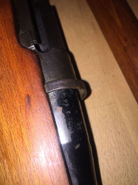

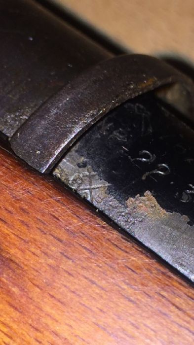

I have tried to take some better pictures of the barrel markings, I will take the fore stock off over the weekend to see what’s underneath, in the mean time
I have also taken a photo of the charger guide, this hole was for the scope rail, the other photo is a close up for the holes for the front of the scope

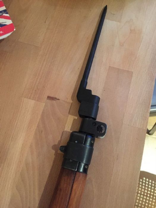

A picture showing the bayonet lugs work!
Lastly a full length picture of it
I have been going through Stratton’s book (shown) and I too now think it’s definitely a sterling conversion

Faux 7.62mm L8A5T with a South African Armscor No9 Mk1 bayonet...
