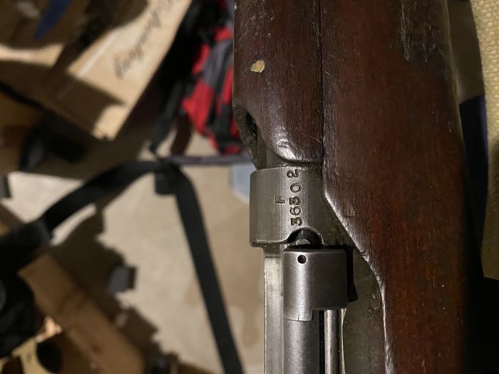

How collectible is a 1945 Australian Lithgow that is all matching ?
I assume less we’re made in 1945 ….

I think more collectible means in this case, made at the end of the war, maybe not issued or thrown round the hills in a war-time environment. so more likely to have been nicely greased and placed in some sort of storage so that it arrives in the current owners hands in as near new / unused condition as possible.   best case still in the mummy wrap.........

Its not new in the grease and I have not seen one as such. This one isn’t beat around but was used but can’t say if during the war.

Looks like a nice rifle it has a mix of BA /OA parts (Bathurst and Orange Factories ) if the numbers all match which by the pics they do you have a great looking rifle .

Has matching numbers on the receiver, bolt, forestock and nose cap. The bolt and receiver have matching “assembly” numbers. The rear sight does not have a serial number.
Yes a mixture of BA and OA parts - should they all be BA or OA marked? Not versed in Lithgow rifles.

I have several rifles FTR in 52/53 all are matching numbers . Some of the trigger guards / sights / sight ears and bases are marked up with different mfg marks ie FA BA OA MA And star marked parts . I did see that if the rifle
Is earlier in production ie pre 1924 they tried to stick with period correct parts.also have seen some replacement barrel are not serialized to the rifle as well with no numbers at all.

Serial numbers were omitted from the barrel and rear sight in Lithgow production by the time your rifle was made so that’s totally normal. It’s also totally normal for these rifles to have component parts from the various feeder factories and marked as such. BA, FA, OA, WA etc. it would appear you have a nice original Lithgow. It’s actually a good example of a JJCO marked rifle that’s an original Lithgow built rifle and not something assembled out of parts by JJCO. We still call them Lithgows but to be more specific, your rifle was built at a town called Orange. Rifle production was moved there in the later part of WW2. After the war, production moved back to the main plant at Lithgow again.  That rear band would have been blackened when it left the factory though. As for collectibility, I think any SMLE that’s original and matching is collectable. As time goes by, they’re getting harder to find.

I'm not seeing the JJCo stamp on this one.
I have a JJCo  No2mkIV* that has the stamp JJCo on the right hand side of the receiver, close to the bolt handle area.
Where is it stamped on this rifle?

On the charger bridge

This is close to mine - about 375 apart.   Mine is also a JJCO, but like yours all matching, and appears all complete.   It is also in very good condition, and I shoot it several times a year (although I am a lousy shot).  I just checked and brass was used from April 1942 through 1945, when they switched back to steel.   Someone else correctly identified the brass would have been painted black.
