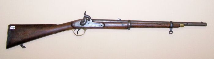

he!!o everyone, New guy here just getting into Enfields and I could use some help identifying one if anyone would be so kind. It is stamped 1863 Enfield and has the crown and VR markings. It is a two band percussion cap .577 carbine with a bayonet lug. I was told that it is an artillery carbine but am not sure as I think those are pretty rare. The barrel is 24" long. Can anyone shed some light on this for me?
Thanks in advance!

it is a pattern 1853 , the short version , there was a longer one as well , these were used extensivly in the US civl war , mostly by the south as they were trading with england at that time ,

Thanks for the response. So would it be considered an artillery carbine, musketoon, or just a carbine?

i believe they refered to them as a three band - for the long rifle , and a two band for the short version , there are a couple others here that might add better knowledge than my old minds recollections , not sure they used the word "carbine" exactly but i do think it was issued to artillery crews ,
i had one once in my collection but it was the three band and i never dug very deep in the research as my interest was more in cartridge rifles , i also had a snyder conversion of one of these - simioar to the US trapdoors these were conversions of the muscates to cartridge loading ,
i rather like whar i see in your photos but i cant give you much more , terry lee might add to the thread when he drops in , this site for the most part are interested in the later rifles , these might get addressed better in the british militaria forum , they concentrate a good deal in the older weapons and have a very knowledgeable group ,

You will likely get more information over on the British Militaria Forum, they have a sub-Forum covering the P53 muzzle loader.
This forum covers the Lee Enfield, a much later bolt action rifle.

I'v never heard them referred to as a "carbine". (Doesn't mean they weren't - just I don't seem to get out much).
Take a good close look at the bayo lug. I've seen 2 banders that had bayo lugs added after they were shortened.
Doesn't mean this one did - just askin.

Some info here on the 1856 short rifled musket, Calvary and Artillery Carbine.
https://www.americanrifleman.org/content/this-old-gun-pattern-1856-enfield-cavalry-carbine/" rel="nofollow - https://www.americanrifleman.org/content/this-old-gun-pattern-1856-enfield-cavalry-carbine/

Snap! Same as mine. A Pattern 1856 Short Rifle as issued to the British Rifle Regiments and Sergeants of the Line

Oh wow! that is great! Do you know if they were referred to as an artillery carbine by chance? Are they pretty scarce or commonly found?

The Enfield M/L rifles previously referred to are not carbines. They are Short Rifles as issued to the Rifle Regiments and sergeants. I attach photos of the Pat. 1853 and Pat. 1861 Artillery Carbines.
One could possibly say that the Pat. 1856 Short Rifles are the more common of the uncommon!

Thanks for posting that! The bottom definitely resembles mine.

The Pat.1856 Short Rifle compared to the Pat.1861 Artillery carbine. The length of the Rifle is 123 cms.
and the Carbine 101 cms.
