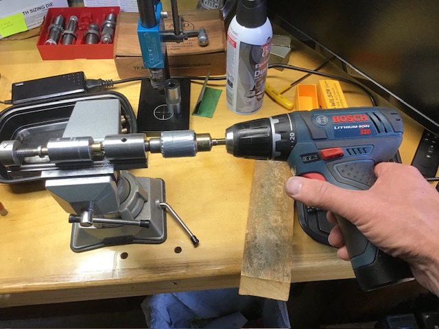

I had no trouble drilling the hole thru the center of the Berdan anvil. The frustrating part was getting the depth set right so as to drill thru the anvil, but not the spent primer. These primers are crimped in place, and many times, the recapping pin punches a hole thru the spent primer.
Once hole is drilled and primer is removed remaining steps are:
Clean the remainder of the anvil off with a pocket depth uniformer
Chamfer the enlarged pocket opening with a case mouth chamfer tool
Press the bushing in using arbor press
Trim the bushing flush (if necessary) with the case head with L E Wilson case trimmer
Ream/chamfer the bushing with a LR primer pocket chamfer tool held in the LE Wilson trimmer

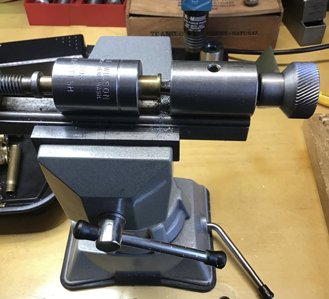

Here is my setup for pressing the aluminum bushings into the Berdan primer pockets.
LE Wilson .303 Case gage, supports the case at the shoulder. Note that the case head sits above the gage as these are partial length sized cases to fit the chamber, not full length sized.
K&M Arbor Press pushes the bushing into the primer pocket. The bushing protrudes by a few thousands of an inch (case on the right), this gets trimmed off square to the case body with a LE Wilson case trimmer, with the head against the cutter.

Got a batch of 60 cases done. The worst part is I had to ream the bushings after fitting.
The DAC 1951 Mk 7 cases have a Berdan primer pocket ID of 0.243 inches. The bushing OD is 0.256, far too large. It took about 100 lbs force to press them into the case head. That reduced the bushing ID to 0.201 for a primer that measures .210.
Reamed the bushings with a LR pocket reamer, which gave me a final pocket diameter of 0.208.

Got tired of turning the primer pocket reamer by hand.  Amazing what you can do with duct tape.

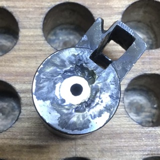

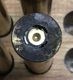

Well, my first trial with these converted cases did not end well. I fired 10 rounds. Although the group was good, three of the cases blew/melted the aluminum bushings in the primer pockets. Why this happened, I do not know. Perhaps the high stresses resulting from the relatively large interference fit into the primer pocket were the cause, the bushings would have had to yield to fit in the pockets.
I will contact the seller of these and see what he thinks.
The bolt head was destroyed by the hot gasses.  A very disappointing result.

 I think the Canadian .303 Mk 7 case Berdan primer pocket diameter must be smaller than the European Large Berdan pockets, the bushings were just too large. If you look back on my earlier posts, it took over 100 lbs to press them into the case, then I had to ream them to accept the LR Boxer primer.
Hopefully, I’ll get this figured out. For starts, it will take a different sized bushing.  I’ll pull down the other 40 rounds, will likely have to scrap the cases.
Fortunately, I have several spare #1 bolt heads the same length as this one.

was the boly head actually damaged or just needing cleanup ? it did not appear damaged - only filthy and it looks like it can be cleaned up ,
Date Posted: January 31 2024 at 3:38am
Badly melted around the primer.  This bolt head already had some pitting from a cracked primer that happened a few years back, but this issue made that much worse. The picture I took was after wiping it “clean” with Hoppes.
On the tenth shot, I could see a flash of flame coming from the back of the breech, that must have been the worst of the three primer pocket bushing failures.  I had looked at the case head after the first shot, and it looked OK, so went ahead and shot the remaining nine.

Bad news about that bolt head Geoff. Those cases look horrendous!
Personally I don't think the an insert between the case and the new primer is a good idea. You have two circumferences to seal. A bit like fitting two headgaskets!
 With the amount of pressure and heat, an insert would need to be threaded into the case to be reliable; but probably not enough material for that method.
Date Posted: February 01 2024 at 7:12am
Yes, that could be. But, these have apparently worked on 7.62 NATO cases.
Perhaps the aluminum was work hardened too much because of the large interference, 0.013 interference on 0.243 diameter Berdan pocket.  I don’t think these bushings are the correct size for these primer pockets.
Still have not heard back from the vendor.
Date Posted: February 01 2024 at 9:31am
I would also assume that with the large hole you drill centre and the 2 other berden  holes, one would think your creating a path of lesser resistance. Basic physics.
Not a great idea really. Gas will push back for that split second it takes to over come pushing the bullet out of the case.
And in your experiment that`s exactly whats happening.
Plus as Zed said having 2 circular sealing surfaces further exasperates the chance of failure.

This happens in all center fire cartridge cases. The gas pushes on the primer, and it expands radially to form a seal and is prevented from blowing out the back of the case via the bolt.
This is a commercial kit that I bought, and has successfully been used. But for some reason, the aluminum bushings are not sealing against the case head primer pocket. My thoughts are because they have been overly strained to get them to fit into the primer pocket (they are too large in diameter for these cases). Once squeezed down past the yield point, they must be springing back just enough to no longer seal, or just on the edge of sealing.
Wish the guy who makes these would call me back, he may be able to get a different size of bushing.
