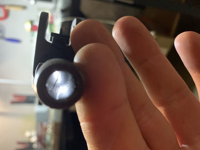

he!!o everyone, I would like to kindly ask about dark ring (bulge?) under the bayonet lugs area on my Long Branch No.4. I’ve seen a few topics on different sites but I never found an answer if the rifle is safe to shoot. Other than this the Bore is tight and looks in perfect shape. Thank you all in advance.[IMG]uploads/7192/IMG_3192.jpeg[/IMG]

I’m not able to measure it because it’s located under the bayonet lugs and in that place the barrel is thicker. But when I shine the light from the chamber there is black ring so I assume that must be bulge since the light can’t reach there. I can send you a photo via email if you want.

But the ring is in the bore, not outside the barrel, it doesn’t seem right to me. I have a photo but I’m not allowed to post pictures since I’m new, But I can send it to you via email if you want.

Date Posted: February 10 2024 at 7:27am
Here`s a pic of the issue he pm`d me.
There appears to be a flat ring inside the bore.
Does this go right out to the muzzle??

Nope, it is only under bayonet lugs. Muzzle is tight almost as new. Thats why I dont get it, I’ve seen at least 3 indepent topics on different sites where people have this ring exactly on the same place as I do.
Date Posted: February 10 2024 at 7:39am
Huh. No guesses on that one except, from the picture,  it looks like there is no rifling from the muzzle inwards to that dark ring, suggesting that someone has drilled out the issue and now the rifling ends where that dark ring begins?...

I suggest looking close at the muzzle for rifling, see if a .311 diameter bullet can be inserted in the muzzle. If it can be, all the way to the base of the bullet, someone did drill that out.
That “dark ring” could be a shadow caused by an actual bulge in the barrel, which would be detected externally on the barrel outer profile.
Either way, I wouldn’t shot it…

Maybe I’m not seeing the picture correctly but to me it looks like the barrel has been counterbored. Usually done to repair a damaged or worn crown/muzzle without shortening the barrel. If that’s all it is, the rifle should function fine.

Did you measure the barrel OD with calipers? Check to be sure there is no measurable outward bulge at this location.  If not, then I don’t know what this could possibly be. The barrel cannot have been made this way, boring tooling could not have done this.
Barrels can indeed bulge if it was shot with some form of obstruction, even a cleaning patch left in the bore can do this.  Can you feel this area with a cleaning rod and snug fitting patch?  If it is a bulge, you will feel less resistance with a cleaning rod.

Try this! I manipulated the image a bit to see the interior shot of the bore better.
You can see the rifling restarting again after the "dark area".
If it is a bulge, that's exactly where I' expect it if the muzzle were "poked in the dirt" & a round fired.
Not conclusive but a possible clue.

The OP's barrel from a different angle. From a machinist perspective, that dark ring looks like a heat treatment issue after the rifling process...

Make a feeler out of a paper clip like we use to test for incipient head separation in a cartridge case and see if you feel an increase in diameter of the bore at that point.
