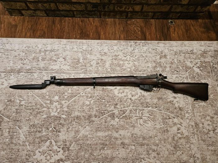

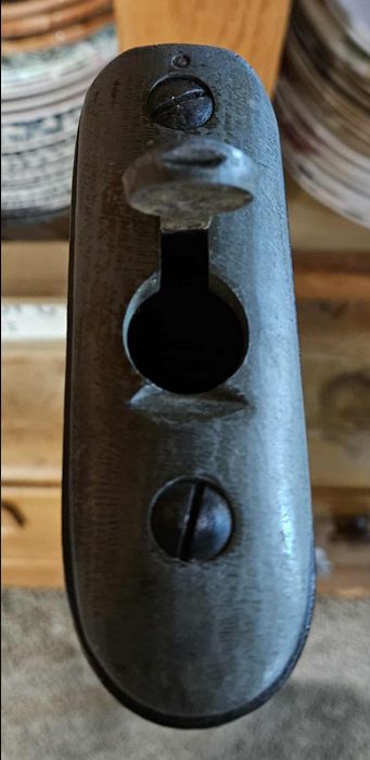

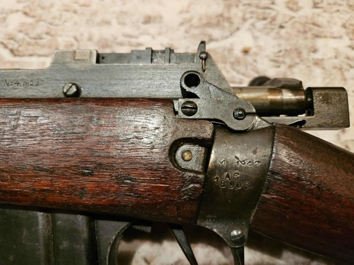

Hi, thanks for letting me in.  Having a hard time figuring out this rifle. Looking to make it complete by digging for a cleaning kit for the stock, so need to know what it is exactly. Other than 1942 No4 Mk1.  ;)

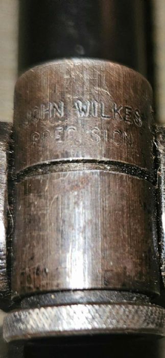

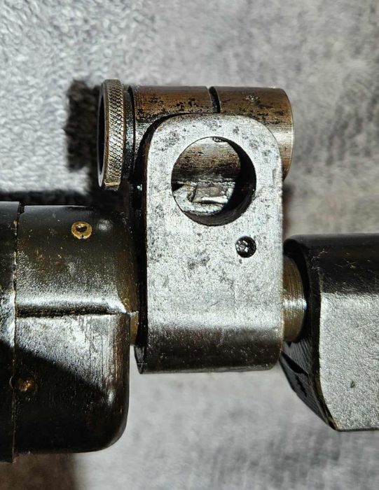

I believe that is a Maltby No. 4 Mk I.  Someone has found a means to attach a tunnel foresight to the front sight protector, that is not standard issue.
Hopefully Bear will come along and confirm it’s a Maltby.
Date Posted: September 03 2025 at 2:11pm
I have one of those front sights but can't figure out to mount it.
Date Posted: September 03 2025 at 2:19pm
Looks like it just fits between the “ears” of the sight protector.
Perhaps Mick will come along and enlighten us!
By the way, I don’t think these foresights were allowed in UK and Commonwealth Service Rifle (b) competition, they came in at the time of the Target Rifle Class in 1968/69. Again, something that Mick knows well.
Date Posted: September 03 2025 at 3:05pm
The front sight block needs to be cut to fit the dovetail IIRC. Plus your rear-sight settings will now need to be recalculated because of the changed LOS form the taller sight blade.
The cleaning kit is simply an oil bottle & a pull through cord.The bottles come in brass, Bakelite & some kind of clear plastic.
Top right of this little group, the rolls of "Foah Bee Two" were the "patches" you tore one off at the red line, but were not carried in the butt trap.

1942 Maltby, stylised “M” ahead of the date.
Date Posted: September 03 2025 at 5:44pm
Maltby made rifle for sure.

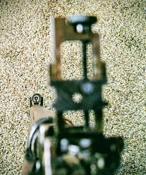

Ideally with the tunnel fore sight, you would use the dioptre rear sight, such as the Parker TZ4/47.
Obviously you can shoot it using the standard rear sight, but if the rifle has been set up (stock bedded etc), it would be nice to complete it with a suitable rear competition sight.

To make it complete (not just the cleaning kit), from what can be seen in your pics, that front sight makes me think you'll have to replace the front sight block and that front aperture sight currently mounted in order to go back to the front service sights.

From the pictures it looks like the rear sight is cranked a fair way up its travel. I assume to make it shoot to POA with the tunnel (called a globe) front.
Honkytonk, They come in 2 diameters, if you have the larger one it won't fit without removing the foresight protectors. Some have the dovetail cut for the standard sight block, but some don't. You'd have to check the diameter (just measure "ears" I.D. & sight O.D. the sight has to be less than the ears. You cold check the dovetail be comparing it with a spare front sight blade.,
Geoff, you're spot on regarding the fact that these foresight conversions were not allowed during the golden years of SR"b" which I take to be 1946~1968.
The NRA (UK) changeover to 7.62mm from .303 at Bisley was a slow affair and the NRA (UK) allowed the use of .303 target rifles to compete alongside 7.62mm rifles from 1968 until 1973 but allowing .303 rifles to use ring inserts for the new style round bull targets which replaced the "tin hat" target.
I have a couple of converted No.4 protectors like the one in the image; their use at Bisley was a brief five years and probably slightly longer in club competitions.
Some years ago I spent the day with the late John Good who made Brindles sights and was at one time the armourer for the NRA, he referred to these foresight conversions as "privateers". The reason they were called that was because the NRA allowed them but there was no official pattern to adhere to so shooters would get somebody with a bit of engineering know how to fix a foresight tube into a No.4 foresight protector.
Some of them are things of beauty...others not so!

From the photo, there does not appear to be much clearance between the tunnel sight tube and sight protector.  I wonder if the protector ear inner surfaces had to be machined or filed down to allow some clearance with the tube?  While not an issue with a TZ or PH 5C target type back sight which allows ample windage adjustment, not having a means to adjust the foresight for windage with the standard service Mk 1 aperture sight would make zeroing the rifle impossible. And as Shamu pointed out, the elevation of the Mk 1 backsight would have to be raised well above the range index marking to obtain a 100 or 200 yard zero.
It may be best to remove the front sight components and install the standard issue foresight block band, blade and sight protector.  Then sell the tunnel foresight assembly separately.
The Parker Hale 5C and Twin Zero windage adjustable target type backlights are getting expensive, $300 USD.  Hard to say if going that route will fetch more for the rifle than what the additional cost of getting one of these sights is worth.  The problem is that competition rules here in the US (Civilian Marksmanship Program) for vintage military service rifles do not allow target type sights, the rules state “as issued” sights except the aperture may be reduced in size.
