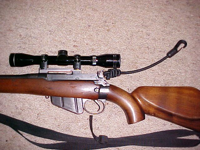

Morning Folks, I pop in from time to time and was quite surprised to see this thread still active. Forgive me for not posting that I had long finished this project, I thought I had posted a progress report.
Since this photo I have fitted a Leupold VX3 1.5 - 5 x 20 Scope as recoil smashed up the Chinese made Tasco Worldclass 2-7 x 32 Scope on 3 occasions. To Tasco's credit they honoured the Lifetime Warrantee and repaired it twice for me and on the 3rd occasion managed to track down an old Japanese model, rebuilt it and gave me that in it's stead. In the mean while I bought the Leupold and mounted the Tasco on my heavier recoiling 45.70 Lever with no further issue's
http://s243.photobucket.com/user/jackoarcher/media/Scoped.jpg.html" rel="nofollow">

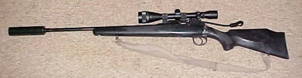

Hi there Jacko I have had a 303-35 for quit a while strangely enough my rifle looks very much like yours mine is on a #4mk1 action and a slightly improved case my load is a 225 sierra gameking and 50 gn 2208 giving a velocity just over 2400 fps getting the rifle to feed the slightly fatter case just took a bit off fiddling but they feed well now . The 9.5x56R is a much fatter case and my son and I are working on them now we just took them out today for the first time working up a load at the moment we are up to 225 gn hornady projectile with 58 gns off 2208 giving around 2500 fps no signs off pressure and still plenty off room in the case .I haven't played with the magazine yet my rifle is built on a 1900 BSA Le1* action I will post some pictures. a future LE project will be a 405 Winchester on a #4 action I think that magazine and feeding will be a challenge.Cast bullets are something we are getting into the cost off these bigger projectiles is a bit horrific. Good to here about your projects.
regards Musso

Hi Jacko I just posted some photos on another post I thought I would add them here too the top rifle is my 375x56 and the lower is my 303-35 some other photos on 375 flanged nitro express page .regards Musso

That's a Lithgow 303-25.  Great cartridge.
The clip is on the end of a shock cord and gets clipped onto the strap of my back back.  That allows me to carry the rifle muzzle down and hands free.  To shoulder the rifle, all that is required is to bring it up to the shoulder.  If time allows, it is quick and and easy to unclip.  The muzzle devices ensure no debris gets into the muzzle and no scope gets thumped onto the eyebrow.  Not that the 30-25 has much recoil to start with but the 303 is a dream to shoot.
