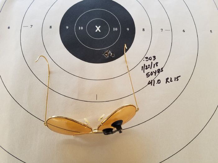

Posted By: RCB1917
Date Posted: January 28 2018 at 7:37am
Shot off bulls bag, with 174 SMK. I think it shoots better than I can see.
