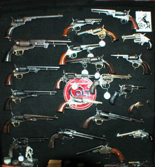

Posted By: Stanforth
Date Posted: December 09 2018 at 4:28am
Not all pistols were confiscated here in the UK..  This is one of 3 cabinets of pistols that I own.

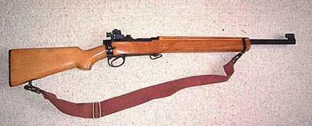

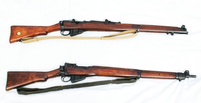

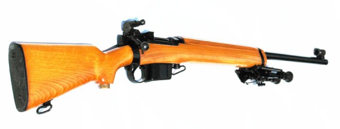

Date Posted: December 09 2018 at 4:43am
And some rifles..
